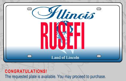

I guess I should get it once there are five engines running rusEfi?
