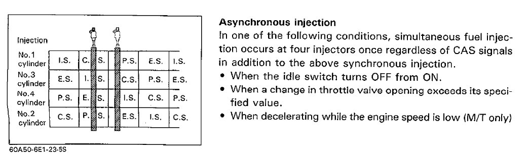

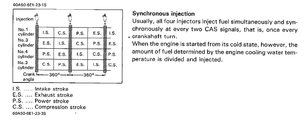

One smaller injector with two pulses is the same as one larger injector with one long pulse put you can get better accuracy under lighter loads such as at idle because any jitter on the injector pulse has less effect. On the MPI Suzukis the second pulse gives an injector strategy like batch injection, on the TBI models an extra pulse is added after the primary pulse. I will look out some more info later, the overall concept is described in the FSMs, even the 89/90 Vitara models that were fuel only used this strategy.
I think the MX5/Miata FSM may also contain some information on this.

With this strategy you have longer injector pulses at low load, any jitter in timing is reduced because its a percentage of the pulse length . At higher loads its less important because economy and emissions are less of an issue. As well as the timing issue as soon as the injector opens the pressure starts to drop so long pulses either can't be accurately calculated or a much bigger fuel rail is needed.
Its not simply a case of fully synchronous switching to batch fired, many batch-fired will switch to firing on every TDC event, TBIs will add an extra pulse between TDC events. I thought the early MX5 switched to firing every TDC when the WOT switch was activated, although the FSM indicates that it doesn't, its a while so I an one on the bench. The images below are from an early batch-fired Denso, a very similar ECU to the 89-90 MX5:
Note. They call it synchronous because its fired synchronous to the CAS rather than on the IFS pulse, this was before fully synchronous systems. I will find a later example, not all the FSMs describe this, the FSM for the TBI only shows 'normal operation' but it can be seen on a scope.

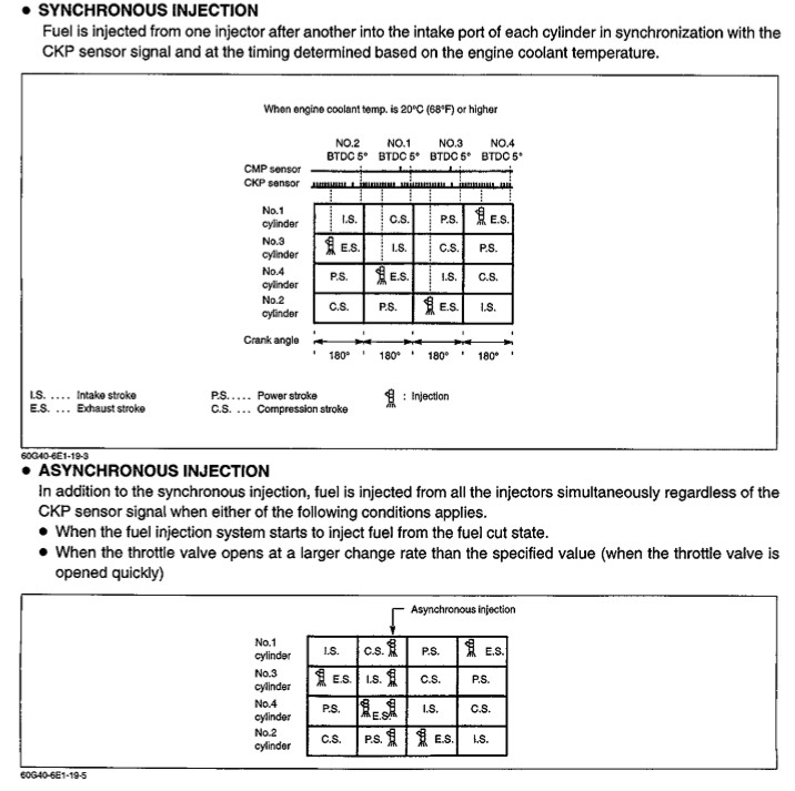

Re: Hybrid injection strategy
This one is from a later model with a 16-bit ECU with a TPU running custom Denso code:
Technically is doesn't switch to batch injection but instead it adds a second pulse a short period after the main pulse.

Now I get it! They are using it for cranking- rusefi already has that capability, and for accel-enrichment. This is presumably, so they don't have to do the math to add to the primary injector pulse. rusefi is taking care of all of that much more elegantly already. Accel just adds to the primary pulse.Rhinoman wrote:This one is from a later model with a 16-bit ECU with a TPU running custom Denso code:
Most aftermarket EFIs add the enrichment it to the primary pulse but that means extending the primary pulse which is what you want to avoid, particularly if you have stock hardware. They still have to do the maths, the reported injector PW is the sum of the two, you need to access the proprietary data stream to get that.
I'm sure if you check the FSM for the later Mazdas you will find that they split the pulse, I don't have one of those FSMs to hand, I am away from home.
