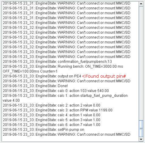

I was mainly wondering what output I should be getting from the pin. Like if I press the Fuel Pump button in Console/Bench Test, should PE4 change from 0 to 3.3V. Currently when I press it PE4 does nothing.
I don't know if this is telling me anything, but this is what I get from the Console dialogue box :-
EDIT
Damn it, I figured it out.
When I press the button it's only on for a short time, and my DMM is so slow trying to auto-range it doesn't even see the rise in voltage.
Tried it on my old analogue meter and it sees the 3V.
Should be right now, thanks.
EDIT
