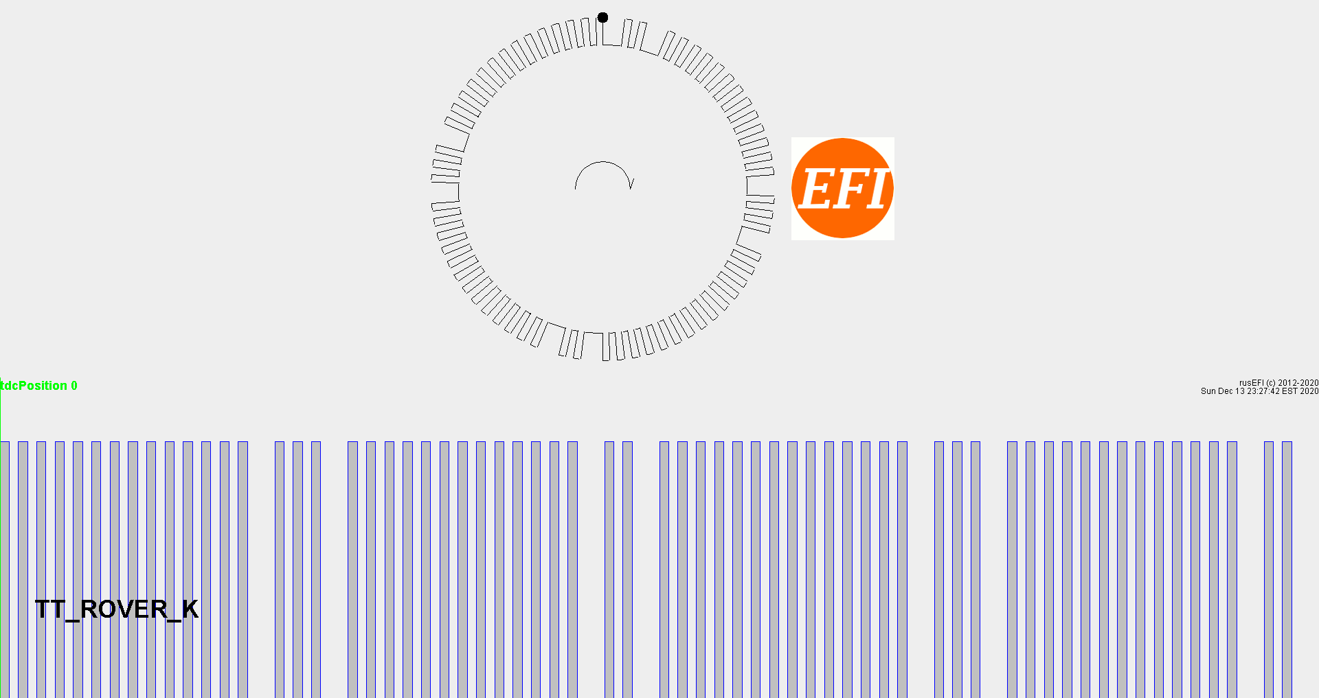

I'm trying to implement support for a Rover K series 36-4 trigger pattern. This is 13-1-2-1-14-1-3-1 where the 1's are missing teeth. There's no camshaft sensor so this needs to sync on the crank alone. Code as it stands is below. It works without the two commented lines but isn't sync'd so TDC can be anywhere. If I uncomment then I get the orange LED flashing and "line:52:msg,FATAL error: totalRevolutionCounter2 expected 3" repeated in the console. Am I going to be able to sort this without adding a camshaft sensor?
Code: Select all
void configureKMpiTriggerShape(TriggerShape *s DECLARE_ENGINE_PARAMETER_S)
  s->initialize(FOUR_STROKE_CRANK_SENSOR, false);
  float tooth = 20;
//  s->setTriggerSynchronizationGap(2.0);
//  s->isSynchronizationNeeded = true;
  float base = 0;
  for (int i = 0; i < 2; i++)
      s->addEvent(base + tooth / 2, T_PRIMARY, TV_RISE);
      s->addEvent(base + tooth, T_PRIMARY, TV_FALL);
      base += tooth;
  base += tooth;
  for (int i = 0; i < 2; i++) {
      base += tooth;
  base += tooth;
  for (int i = 0; i < 14; i++) {
      base += tooth;
  base += tooth;
  for (int i = 0; i < 3; i++) {
      base += tooth;
  base += tooth;
  for (int i = 0; i < 11; i++) {
      base += tooth;
Posts: 14334
Re: 36-4 trigger wheel
PhilTheGeek wrote:"line:52:msg,FATAL error: totalRevolutionCounter2 expected 3"
I will now change this message to be more helpful: what is happening here is your 'gap' ratio is not 2 so synchronization validation fails.
I usually run unit_tests.exe with additional logging to see what are the actual gaps, you can try setting
Code: Select all
engineConfiguration->isPrintTriggerSynchDetails = true;
or add a breakpoint where it does gap calculation in trigger_decoder.
I will now figure this out for you, adding trigger_rover.cpp file as we speak.
Posts: 14334
Code: Select all
addEvent 700.000000
addEvent 710.000000
addEvent 720.000000
TT_ROVER_K event SHAFT_PRIMARY_UP 10000
current gap nan/nan c=0 prev=0
TT_ROVER_K isSynchronizationPoint=0 index=0 SHAFT_PRIMARY_UP

TT_ROVER_K isLessImportant SHAFT_PRIMARY_DOWN 939999
TT_ROVER_K event SHAFT_PRIMARY_UP 950000
current gap 1.000100/0.999900 c=20001 prev=19999
TT_ROVER_K isSynchronizationPoint=0 index=9 SHAFT_PRIMARY_UP
TT_ROVER_K isLessImportant SHAFT_PRIMARY_DOWN 960000
TT_ROVER_K event SHAFT_PRIMARY_UP 969999
current gap 0.999900/1.000100 c=19999 prev=20001

Posts: 14334
grep current
current gap inf/nan c=20000 prev=0

Posts: 14334
Ops, my current algorithm is not capable of synchronizing such a trigger wheel :(
Since you are saying there is no cam sensor it sounds like I would need to improve my trigger decode.
