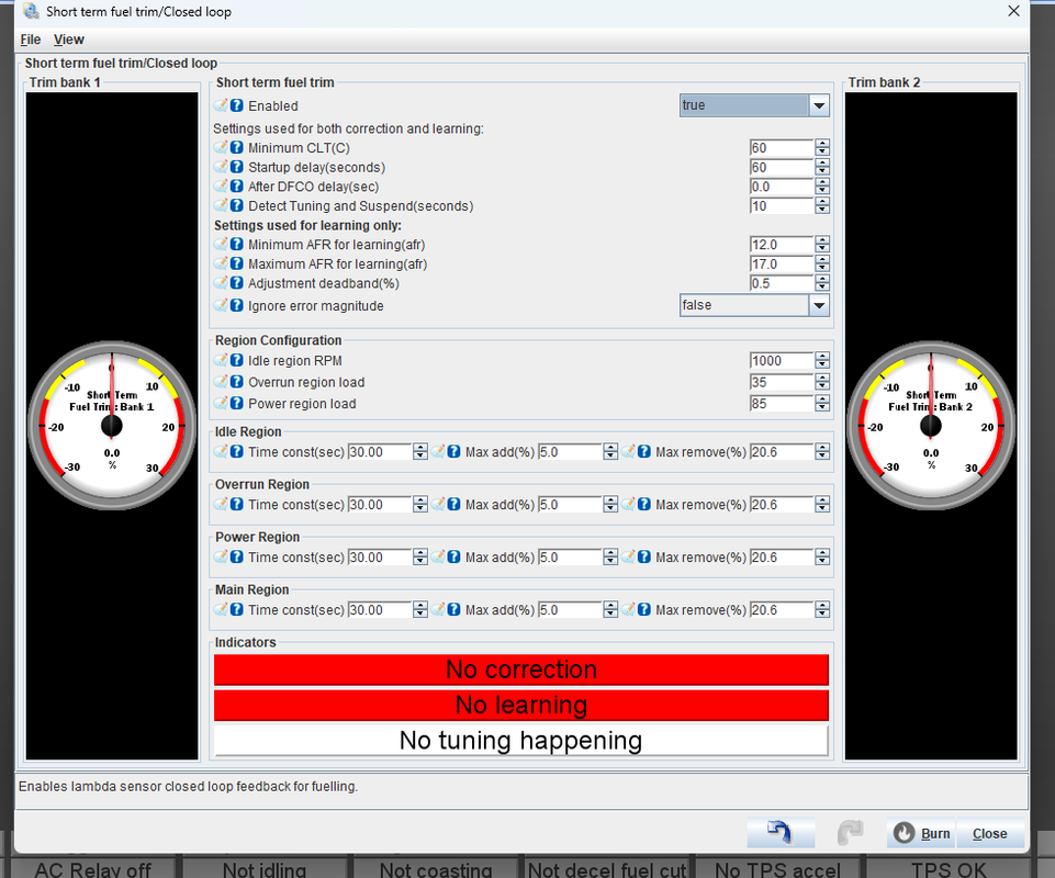

I don't have a rusEFI yet, but exploring configurations in tunerstudio. This Ecu has at least 2 "banks" to do lambda correction. In your case you could use one bank per cylinder.
