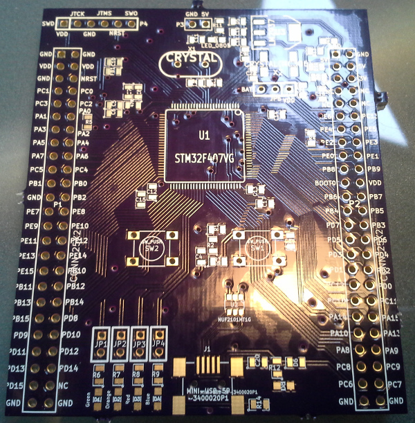

We need our own KiCad board with some stm32f4 chip in order to a) get the schematics ready 2) test my soldering skills
-1) for the first revision, we are targeting STM32F407VGT6 chip which is LQFP 100
0) dimensions: 57mm by 67mm
1) Should be an exact clone of stm32f4 from the pinout prospective
2) needs the same 4 LEDs
3) needs the reset button (?)
4) I guess 'user' button is not needed
5) should have some means of loading the firmware - could be UART or USB
For larger processor see http://rusefi.com/forum/viewtopic.php?f=4&t=749
ibom available at https://rusefi.com/docs/ibom/

Re: stm32f4 main chip module
New version checked in.
Silkscreen is good enough (I am planning to improve it a hair before ordering), the only pending issue - I want to use another EMI Filter chip, USBUF02W6 is just too small so soldering would be painful.

BOM order placed - with all the components I will have a chance to print the board for final validation
So what exactly is the purpose and difference of this board?
- Posts: 14334
because eventually we better make a board with an stm32f4 chip right on it. Less kinks caused by the discovery components we are not using (they make some pins inoperable), less vibration issues, better licensing situation.We need our own KiCad board with some stm32f4 chip in order to get the schematics ready
The board design is supposed to be ready and I have even purchased the BOM so that I can validate the packages against a paper version of the PCB. That's where I got distracted and that's where it is for the last month or two.

I'm afraid of this PCB
The hardest part to solder is the main chip. If you put on to much solder you can remove excass with solder wick. The key is to place the chip accurately. With an iron you can tack one pin down then adjust the far side until it aligns correctly. Then you heat up the original pin to relieve stress. After that your hot air will do the bulk of work.
- Posts: 14334
Set #1. I've applied soldering paste on the board, put the chip above and tried my best to align. Two rows seemed fine, but two I could not see anything because of the paste. Kind of tacked it with soldering iron, seemed ok, applied hot air. Nope, it was off, and funny thing - there just was no connectivity into too many pins. I think this set is pretty much ruined.
Took set #2 and here is the deal: the lacquer layer shapes a perfect bed for the chip! So, it goes right into where it should go - and it would not move anywhere, the edge of the lacquer layer is holding it in place. Fine, I've applied some solder paste above the pins while the chip is sitting on the board. Good news: everything is aligned perfectly, Bad news: since I am applying the paste on top of the paste, I had to re-apply it because nothing gets between the pins and the PCB pads - it all stays above. And once I really, I have too many pins soldered together. And while I was trying to use the wick, I've bend some of the pins They are too fragile.
This second would maybe be fine for a test - even with some pins soldered together it would be good enough for a test, but only for a test.
F@$@ it. Time for some red wine, I am definitely not enjoying soldering TQFP 100. If anyone wants to save set #1 or try soldering set #3, please PM me and I will mail you this stuff.
Another possible tactic might be to apply paste, then heat such that the paste flows, then install the chip. This will ensure you have solder under the leads. Also alignment can often be done off the silk markings. So if you can't see the pads or pins you can often reference the chip edge to the silk.
