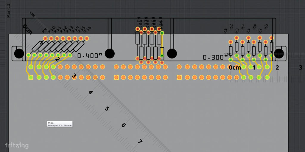

This pic wasn't in this topic, and I was guessing stuff until I found this hard to find photo
I didn't bother making the correct part, but will the centre combination work with the flybacks. The diodes are 2.5mm, and the leg in between is 0.5mm, so the spacing would be 3mm. I put an example trace on the end diode for a SMD part.
Also there's not much room around the screws. I suppose I could use a insulating washer.
What's the INJ current across the 0 ohm resistors. Is it single INJ per mosfet and the STM32 batches them, or can you connect 2 INJ per mosfet. Basically is 0805 ok or do I use 1206.

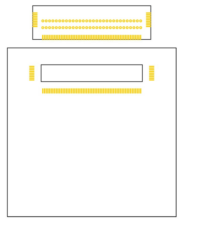

I don't know how well Frankenso kits sell, but after making one it seems a bit too much trouble. You're kind-of better off just paying the small amount extra for the pre-assembled FK, but what would be better is a PnP FK for the different car models. The problem is how do you make a PnP FK to cover all cars.
Do you cut a hole in the FK and make a castellated adaptor PCB with the ECU connector. It would cutout all those jumpers, but it would add $10 to each FK for the adaptor PCB.

China assembly is key. The connector cards is difficult with China assembly. I once dreamed we would make wire boards to simplify the different PNP setups with that connector. If you don't have the frankenso connector you probably do not have the same case in the same location. If you don't locate in the exact same spot you probably need an extension cable. So adapter board that is connected frankenso connector with pigtail. As well that connector is lower qty. So let the diy guy do that part. Then let China do the bulk assembly and keep that assembly the same.

"It seems there are a short circuit on the top circuit line layer , is it correct ?" and send me photos (blue)
Have somebody properly gerbers, which hasn`t got issues on JLCPCB?
Thanks
002 (1).png (396.19 KiB) Viewed 33101 times
001 (1).png (53.9 KiB) Viewed 33101 times
Posts: 14327
Re: Frankenso - ECU shield compatible with OEM case / official
The areas you point on have not changed for a while (or maybe ever?) - I believe other shops never brought this up. All or most of Frankenso in existing look like this and seem to be working. I have some 0.5.6 unpopulated boards but I do not think I have assembled any yet.
