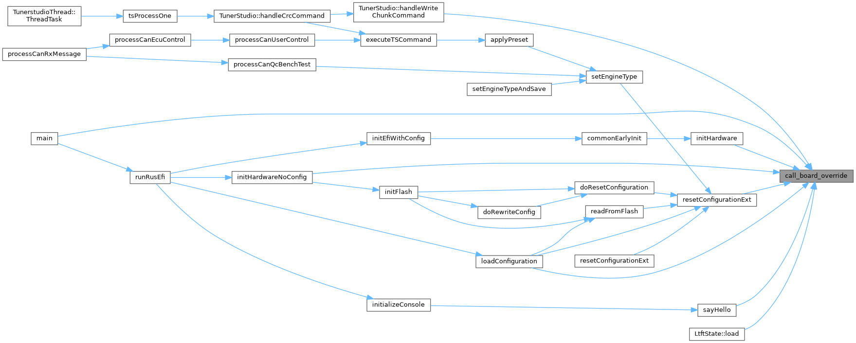

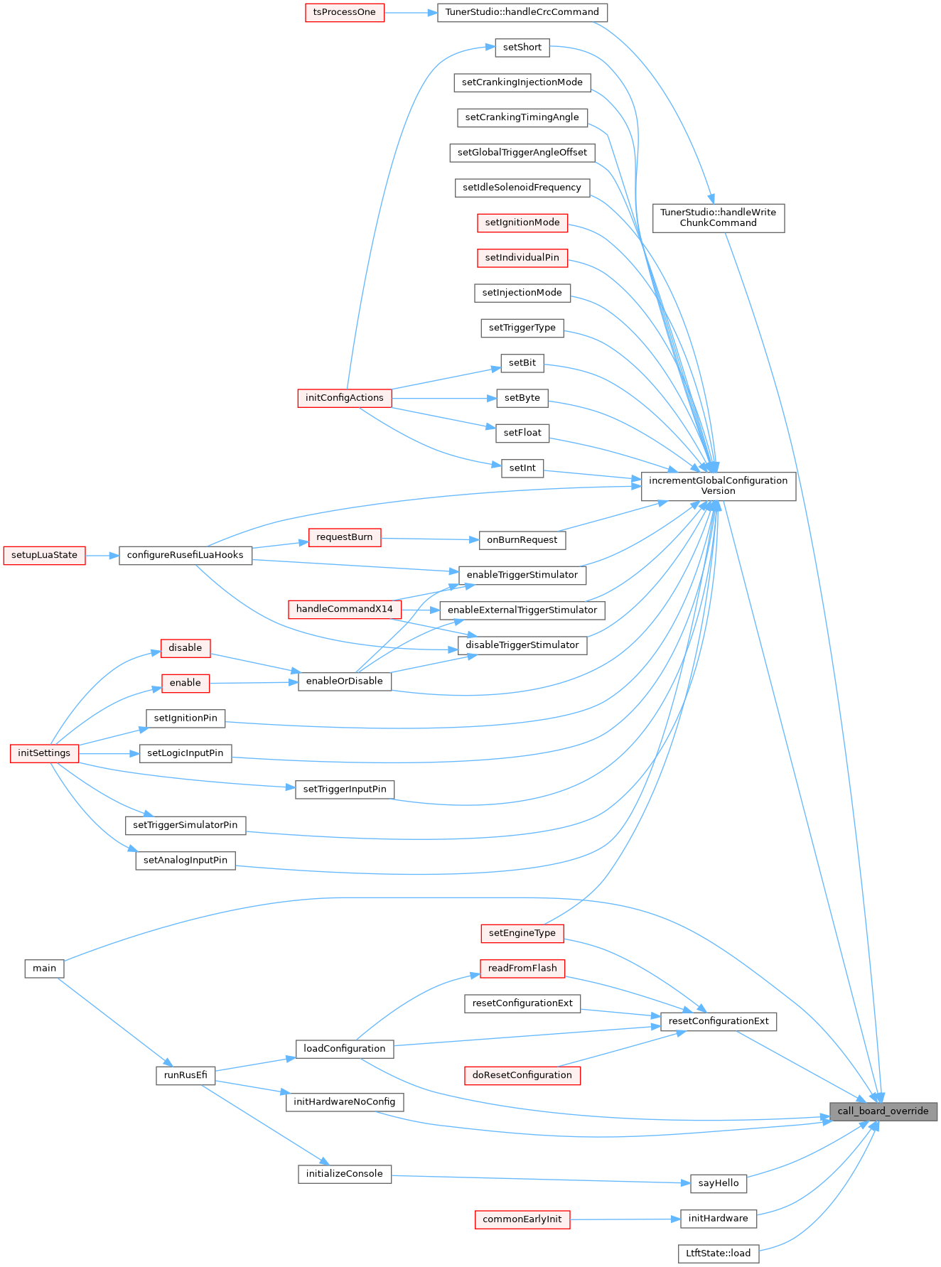

◆ call_board_override()
template<typename FuncType , typename... Args>
static bool call_board_override ( std::optional< FuncType >  board_override,
Args &&...  args
inlinestatic
This function checks if an override is present and calls it if available. Return true if override is present and was called
Definition at line 88 of file board_overrides.h.
88 {
89 if (board_override.has_value()) {
90 std::invoke(board_override.value(), std::forward<Args>(args)...);
91 return true;
92 }
93 return false;
94}
Referenced by applyEngineType(), TunerStudio::handleWriteChunkCommand(), incrementGlobalConfigurationVersion(), initHardware(), initHardwareNoConfig(), LtftState::load(), loadConfiguration(), main(), Engine::periodicFastCallback(), Engine::periodicSlowCallback(), resetConfigurationExt(), and sayHello().
